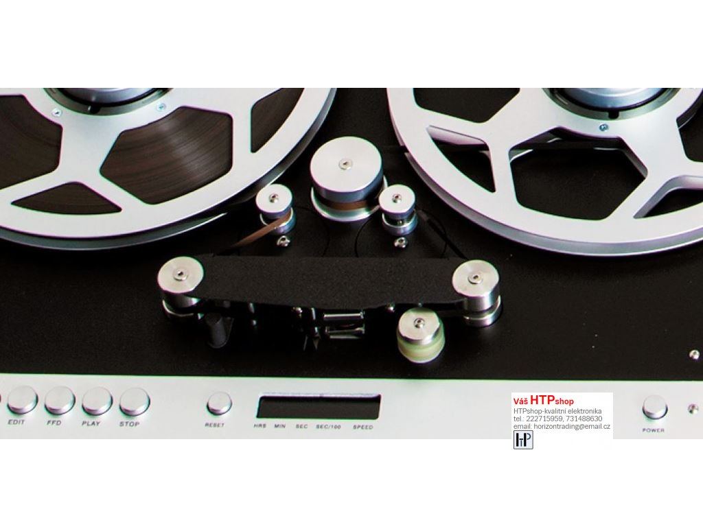

Tape Machine Thorens TM 1600
The new Thorens TM 1600 comes in a plinth very similar to that of new TD 1600 series record players in black high gloss or walnut high gloss. It’s designed as playback device for half track quarter inch tape.
Base for the new machine is the newly developed very compact tape drive from Ballfinger. Within its 50 mm height it gives a freedom of design that has not been seen before. Nevertheless it contains direct drive motors with tension controls for the reels. To keep the whole drive as compact as possible the tape path geometry was totally new designed. So the sensors are not located below the reels as normally but between them above the heads.
The tape machine is driven by three motors. The reel motors are electronically commuted disc motors that use rotor angle detection by hall sensor feedback. The capstan motor is an ironless bell-shaped rotor motor from a German manufacturer that runs a round belt.
Although very compact these motors supply an enormous torque with very small torque variation and are very silent running. Head and capstan motor could be placed far from each other to generate a very high signal to noise ratio. Additionally power supply is outsourced which reduces noise level even more and so extensive measures for magnetic shielding of the heads could be avoided.
Thorens TM 1600 handles reels up to 10.5” with 19 and 38 cm/s. CCIR equalization for most European recordings and NAB for Americas and Asia can be selected.
The tape machine comes with real time counter with hours/minutes/seconds/hundredth seconds and as common with professional studio machines there is an edit function with pre-listening for single hand operation.
Generally Thorens TM 1600 has been designed for horizontal operation. But it’s prepared for wall mounting, too.
