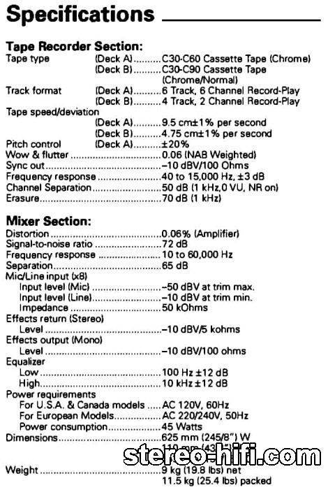

Specifications
Track format: 6-track, 6-channel record play deck A
                      4-track, 2-channel record play deck B
Tape speed: 9.5cm/s deck A,     4.75cm/s deck B
Pitch control: +/- 20%
Wow and flutter: 0.06% (NAB Weighted)
Frequency response: 40Hz to 15kHz
Channel separation: 50dB at 1kHz, 0 VU, NR ON
Erasure: 70dB
Sync out: -10dBV/100 Ohms
Mixer section:
Distortion: 0.06% (Amplifier)
Signal-to-noise ratio: 72dB
Frequency response: 10Hz-60kHz
Separation: 65dB
Equalizer: Low - 100Hz +/- 12dB, High - 10kHz +/- 10dB
Dimensions: 625 x 110 x 343mm
Weight: 9.0kg
Power consumption: 43 Watts
