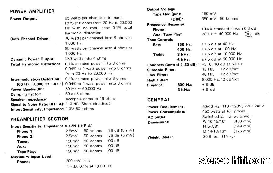

KENWOOD KA-7300
Specifications
Power output: 65 watts per channel into 8? (stereo)
Frequency response: 20Hz to 40kHz
Total harmonic distortion: 0.04%
Damping factor: 50
Input sensitivity: 2.5mV (MM), 150mV (line)
Signal to noise ratio: 76dB (MM), 90dB (line)
Output: 150mV (line)
Dimensions: 430 x 149 x 376mm
Weight: 14kg
Year: 1977
