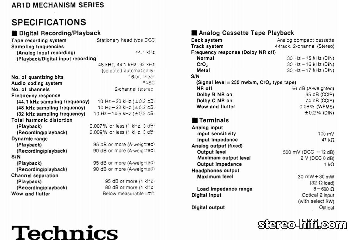

Technics RS-DC8
4th generation Digital Compact Cassette Deck (1994-95).
Specifications:
Type: digital compact cassette deck
Track System: 2-channel stereo
Tape Speed: 4.76 cm/s
Recording Time: 90 minutes
Sampling Frequency: 48, 44.1, 32kHz
Frequency Response: 10Hz to 22kHz
Signal to Noise Ratio: 95dB
Dynamic Range: 95dB
Channel Separation: 95dB
Total Harmonic Distortion: 0.007%
Analogue Inputs: 100mV (line)
Analogue Outputs: 0.5V (line)
Digital Inputs: optical
Digital Outputs: optical
Finish: black
Accessories: remote control
