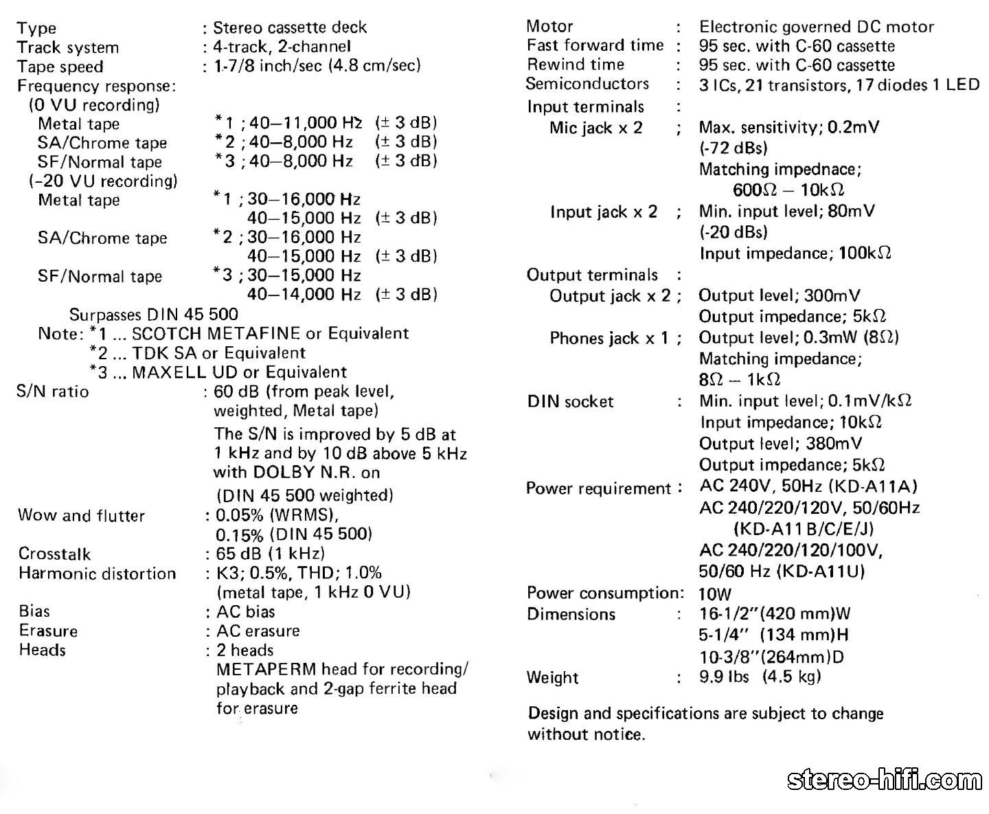

Tape Speed: 4.76 cm/s
Tape Type: type I, CrO2, FeCr, Metal
Noise Reduction: B
Frequency Response: 40Hz to 15kHz  (Metal tape)
Signal to Noise Ratio: 60dB  (dolby B)
Wow and Flutter: 0.15%
Dimensions: 420 x 134 x 263mm
Weight: 5kg
Finish: silver
Year: 1980
Price: USD $170 (1980)
