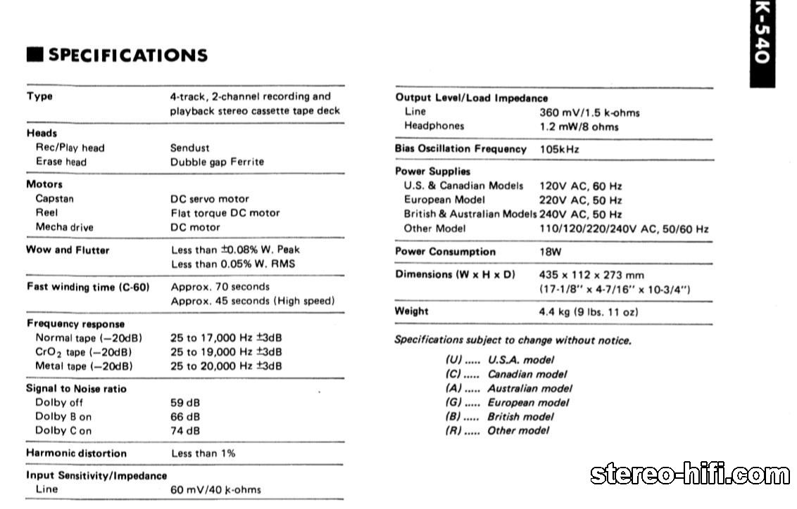

  • Tape Speed: 4.76 cm/s
  • Motor: 1 x reel, 1 x capstan, 1 x mechanism
  • Frequency Response: 25Hz to 20kHz  (Metal tape)
  • Signal to Noise Ratio: 74dB  (dolby C)
  • Wow and Flutter: 0.05%
  • Total Harmonic Distortion: 1.0%
  • Input: 60mV (line)
  • Output: 0.36V (line)
  • Dimensions: 435 x 112 x 273mm
  • Weight: 4.4kg
  • Year: 1986
