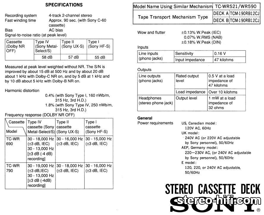

SPECYFIKACJA:
Tape Speed: 4.8, 9.6 cm/s
Heads: 2 x record/playback/erase
Motor: 2 x reel, 2 x capstan
Noise Reduction: B, C
Headroom Extension: HX Pro
Frequency Response: 30Hz to 19kHz  (Metal tape)
Signal to Noise Ratio: 73dB  (dolby C)
Wow and Flutter: 0.07%
Total Harmonic Distortion: 1.8%
Input: 160mV (line)
Output: 0.5V (line)
Dimensions: 430 x 123 x 285mm
Weight: 4.6kg
Year: 1992
