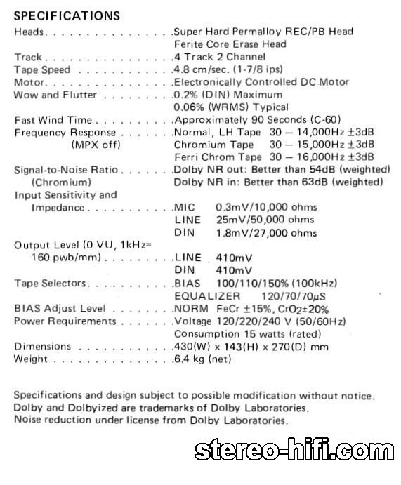

Dane techniczne :
  • Stereo Cassette Deck (1979)
  • SpecificationsType: 2-head, single compact cassette deck
  • Tape Speed: 4.8 cm/s
  • Tape Type: type I, CrO2, FeCr
  • Noise Reduction: B
  • Total Harmonic Distortion: 1%Input: 25mV (line), 0.2mV (mic)
  • Year: 1979
